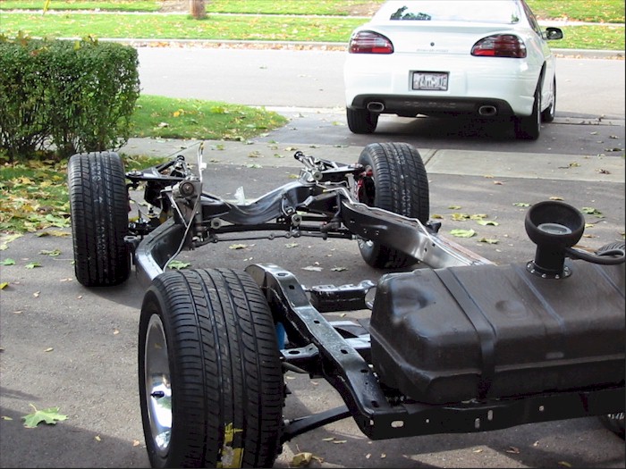

Default 67HEAVEN kisses the ground..........
......just over a year after going up on stands.
We're going to roll it in and out of the garage this weekend to settle the suspension and then complete the torque settings.

lloking good, but is that a fiberglass rear spring I see?
GDaina is offline   Reply With Quote

Body is color-sanded but not buffed.
what grit paper u use? May I suggest using 1000, then 2000, anf finish off with 4000. The 4000 grit will leave a dull polish and ehen u use medium grit compound, will give u a mirror, then anything after that swirl removers, usind DuPont's Perfect It system
But George, Chuck S. told me that fiberglass is "factory correct". After all, it is a Corvette! ;)
67HEAVEN is offline   Reply With Quote
