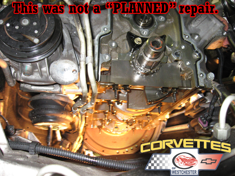

Cameron calls me up and says "I'm stuck on the side of the road." so, I figured he FINALLY broke my 4.10 rear.....
NOPE!

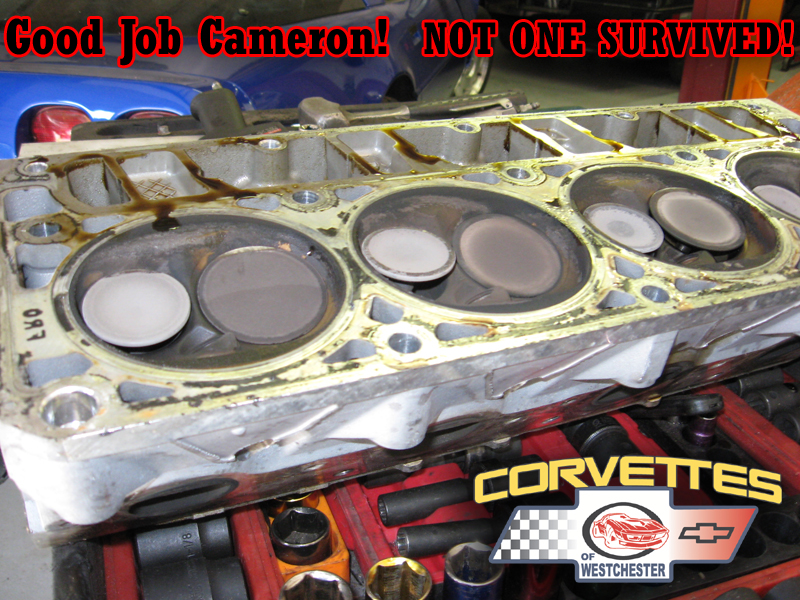

Here is what I found when I tore into the engine....First off...When we removed the valve covers and rockers, some of the valves were stuck down...NOT GOOD.
After removing the passenger side head, here is what we found.

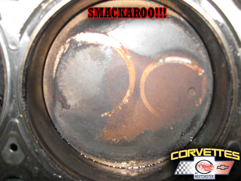

It isn't often that the valve leaves a "perfect circle" on the piston cause it's got to bend the valve almost 45deg to leave that kind of mark...OUCH!
HERE'S MY FAVORITE SHOT. Cameron bent ALL 16 VALVES!!! again...NOT GOOD.
GOTTA LOVE THIS ONE. Suitable for FRAMING.

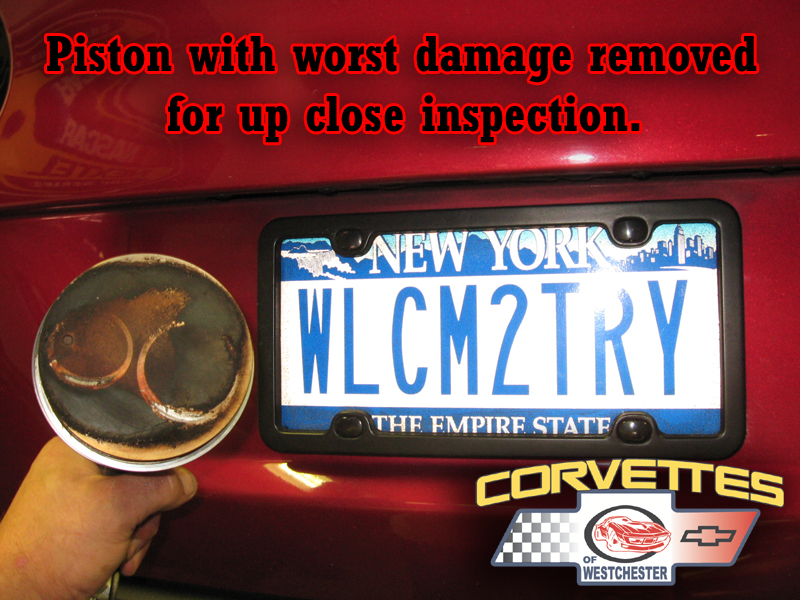

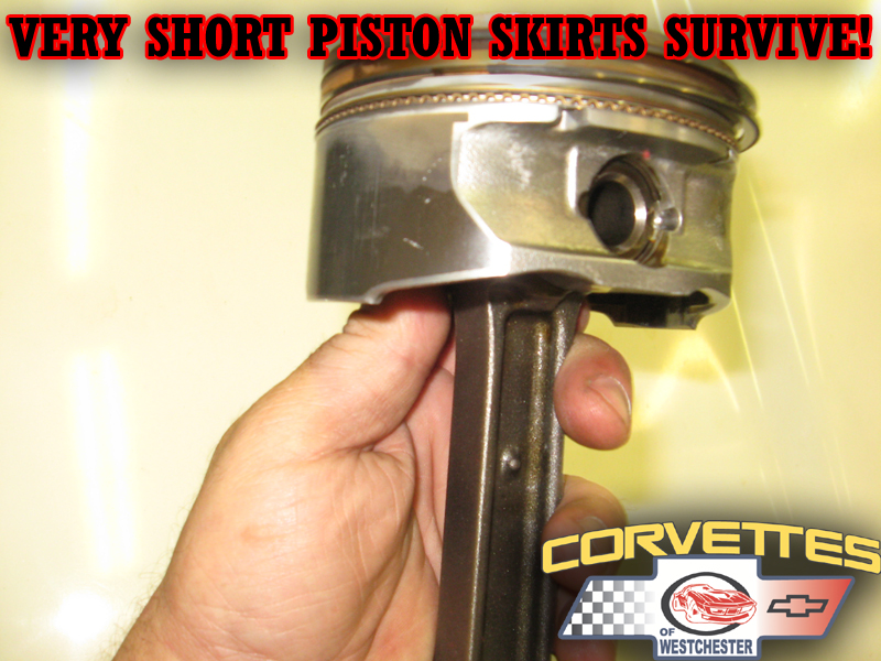

Usually, pistons with longer skirts tend to bend or break after the valve smacks the piston sideways in the bore...These survived no problem and appear to be fine.

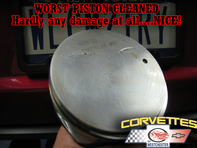

After removing the piston with the worst impact marks and thoroughly cleaning it...you can clearly see that the damage is minimal.

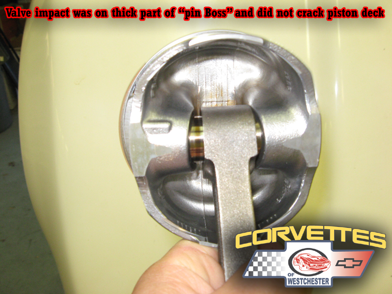

Here it is evident (from the previous pic) that (fortunately) the valve impacted the piston right on the edge of the "pin boss" which is considerably thicker and stronger than the hollow area just below the very thin piston deck. Had the valve impacted the deck of the piston in any other place, it would have likely cracked the piston and created much more serious problems.

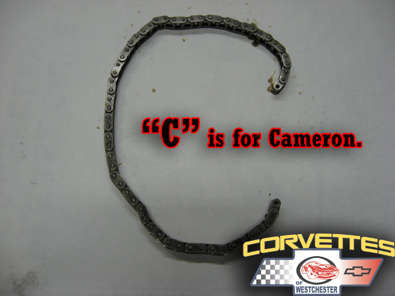

Yes, "CAMERON" starts with the letter "C".

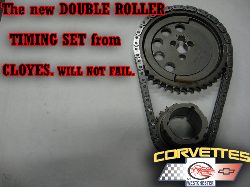

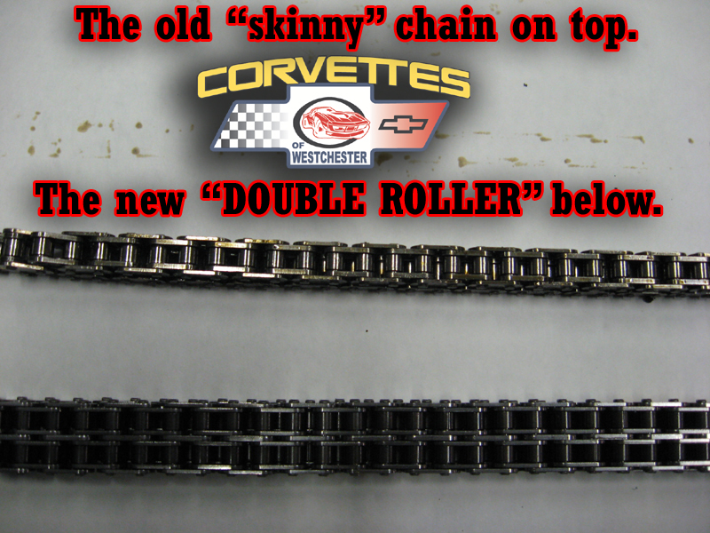

LS2 chains are really good...AND they're TRUE ROLLER CHAINS. BUT, This chain from CLOYES is the deal...CAMERON, I'll buy you dinner if you bust this one!
Which chain would want in your EXPENSIVE HEAD/CAM install????

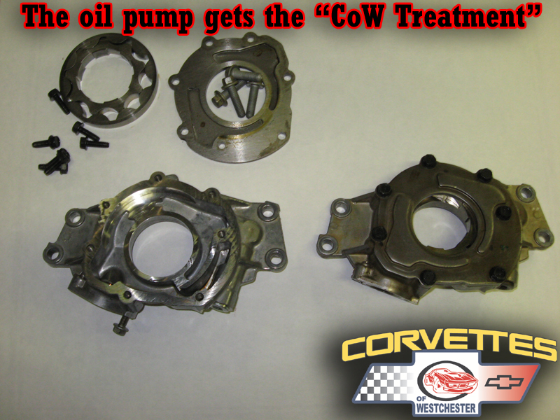

The oil pump on the left is gonna get the CoW Treatment which includes internal modifications for flow improvement and increased pressure. Cameron's car sees 7,000 RPM every time he gets behind the wheel! MO-PRESSA is BETTA!!!

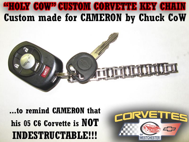

Introducing the latest in Corvette Fashion and Accessories (maybe Nakid Parts is gonna steal this idea from me... ) The "REMINDER KEYCHAIN".
EVERY TIME YOU START YOUR CAR, EVERYWHERE YOU GO....You'll be sure to remember that...ANYTHING CAN BREAK---ANY TIME!

Whoooly cow, hey Chuck when you said you were going to post some pictures on the build I didn't think you meant my mug shot..
Thanks for posting, I especially like the double roller, looks massive compared to the stock one. I also like my new key chain. Thanks for your time and effort Chuck.

Chuck felt that the pistons are in very good shape, due to the area of impact on the piston. I personally was not budgeted for a whole new rebuild and this mishap. I am fortunate enough here to have the labor covered by chuck.
My decision on the rebuild and staying with the current pistons was scrutinized by me and chuck and I personally made the decision to stay with the current short block.
