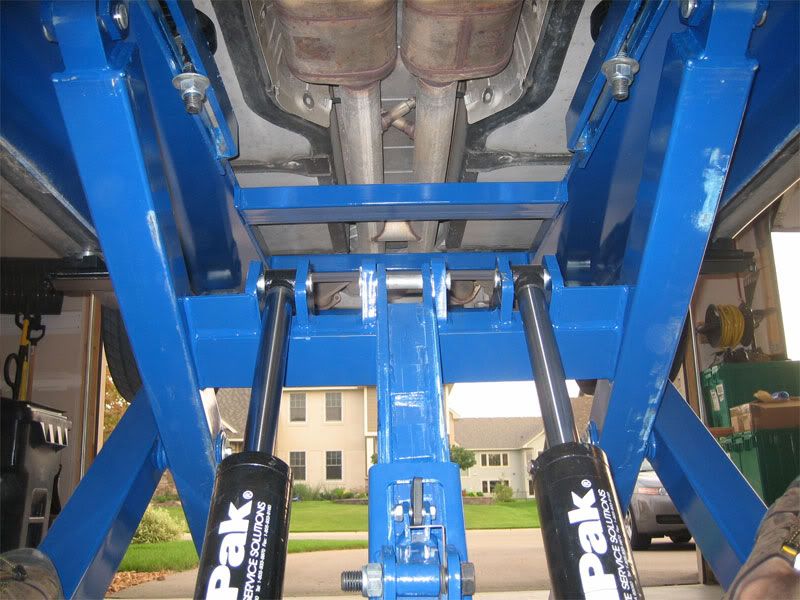

Re your question about oil changes - the lift is nowhere near in the way:

You must have them hidden in the rear somewhere.
Chris's picture above is an excellent shot showing how virtually nothing on the C5 is obstructed by the lift except the frame itself. (other cars may be different). And there is I believe even more clear access in the rear.
The only limitation on the lift is the 48" max height (or 52" with the extenders) which even if there was no limit, my 9' 4" ceiling would be a height limitation as well. Many owners have this same garage limitation.

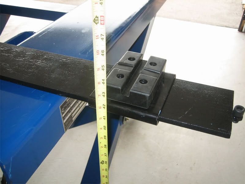

Max lift height – on the the highest mechanical safety – puts the top of the base pad at about 43 inches. That’s essentially 44” from the bottom of the C5 to the floor – FYI in case you were tempted to add the 4 or so inches of ground clearance to the factory figure.
The minimum height listed by the factory with the pads installed is 4 ¾” – that is misleading because the safety mechanism and the hydraulic tubes are both higher than that – important because you may end up dragging your air dam over these parts. The highest ‘low’ point on the lift is the safety – 6.25” off the floor. Plan accordingly.

Lift max height on top mechanical safety
This lift has a lot of open space when elevated – two very big cavities and a very open front and rear – more it would seem than the Norco lift I was planning on getting.
There are more pics below from under my C5, but there shouldn’t be any access problems for most ‘home-grade’ work.

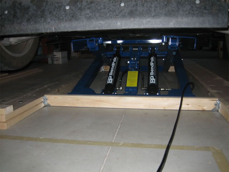

Lift lowered

can you drive your car backwards up that ramp without bottoming out?
it also looks like 3/4" thick (stacked) wood added to the front

Quote:
Backwards shouldn't be a problem at all - the reason I incremented the ramp was for the front air dam which on my car is about 3" off the floor.
The ramps are 1 x 12" pine:
1 - 3' long section on the bottom
1 - 2' long section in the middle
1 - 1' long section on the top
No scaping whatsoever.
