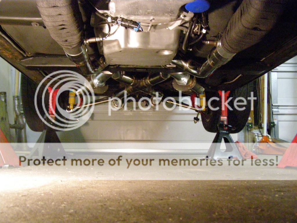

yes those are V-band clamps you see, they are just in front of the Deferential by a few inches. I have them also just behind the transmission cross member as well so I can take out the exhaust if needed to excess the drive line in the future.
Here are a few other older photos of the system with the v band locations, Please excuse the look of the welds, I am not a welder Nor do I pretend to be. The stainless is thin and I had trouble with the welder wanting to blow holes through the pipe until I fugued out what I was doing wrong. I used stainless so I wasn't dealing with rusty pipes later when the system has some age on it, this is not a show car by any means, Its a street car with some occasional Auto cross events mixed in.
Here is a short video of the car with sound clip taken several months ago with a different set of headers and the cutouts moved closer to the floor boards along with some other changes, This will give you a decent look at the rear exhaust exit.
http://youtu.be/JxHvbqD7aOo
Riggs
Riggs

What do you think of the look? It's OK to hate it -- I'm way too old to have sensitive feelings -- except maybe in my feet.
#97
I'd go with a system that removes the rear tire... how often do you really use it? But, it should look BETTER than what the car has w/out spare. Show off the IRS and the trick duals set-up. I like the idea... gets the exhaust AWAY from the tires and fewer bends once it passes under the IRS.
At one point I was going to buy a 4-inch rallye wheel with the narrowest 27-inch tall tire on it and then section the spare tire carrier. Even before I priced the bits and pieces and estimated the work, I came to the same conclusion as you. On the miniscule chance I can't get AAA to come out and fix the flat, I can carry a tire plug kit and one of those $8 compressors under the storage bin with the scissor jack.
Since I'm also doing away with the rear leaf spring, four really nice threaded mounting bolt holes are freed up under the IRS pumpkin. I should be able to fabricate a nice exhaust hanger for that spot.
