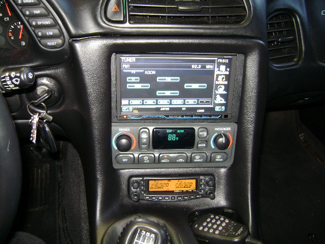

I"ve had a Kenwood 7120 in my '02 Z06 with the Bluetooth adapter for a few months now and couldn't be happier. I opted to use the existing Bose speakers (which I happen to think sound great) and a Pac Audio Bose adapter. The sound is great and I LOVE being able to play MP3's directly off a USB "stick". No disks needed anymore!
Not the greatest pic but here's how it looks (this pic was taken before the console was properly centered but it gives you an idea how things will turn out):
